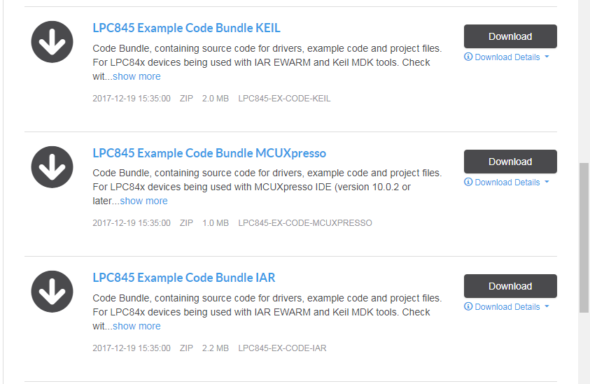

Maybe you can try to refer to the code bundle library which is easier to understand versus the SDK.

And in code bundle library initially I tried developing our application using code bundle library codes,
but only led_demo sample worked, and not got expected result from the other demo codes.
