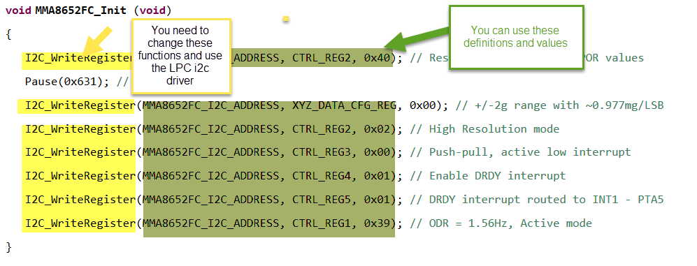

What should I use to initialize sensor and get data from it?? [just like example provided in MMA8652FC - Bare metal example project]
As shown in document :- MMA8652FC - Bare metal example project
void MMA8652FC_Init (void)
   I2C_WriteRegister(MMA8652FC_I2C_ADDRESS, CTRL_REG2, 0x40); // Reset all registers to POR values
   Pause(0x631); // ~1ms delay
   I2C_WriteRegister(MMA8652FC_I2C_ADDRESS, XYZ_DATA_CFG_REG, 0x00); // +/-2g range with ~0.977mg/LSB
   I2C_WriteRegister(MMA8652FC_I2C_ADDRESS, CTRL_REG2, 0x02); // High Resolution mode
   I2C_WriteRegister(MMA8652FC_I2C_ADDRESS, CTRL_REG3, 0x00); // Push-pull, active low interrupt
   I2C_WriteRegister(MMA8652FC_I2C_ADDRESS, CTRL_REG4, 0x01); // Enable DRDY interrupt
   I2C_WriteRegister(MMA8652FC_I2C_ADDRESS, CTRL_REG5, 0x01); // DRDY interrupt routed to INT1 - PTA5
   I2C_WriteRegister(MMA8652FC_I2C_ADDRESS, CTRL_REG1, 0x39); // ODR = 1.56Hz, Active mode

soledad
This example was developed using a Kinetis KL25 device.
If you want to use this example for a LPC device then you need to replace the i2c functions in order to use the LPC i2c driver.
For example:
The MCUXpresso SDK contents i2c driver examples thjat you can use as reference.
Have a nice day!
Sol
