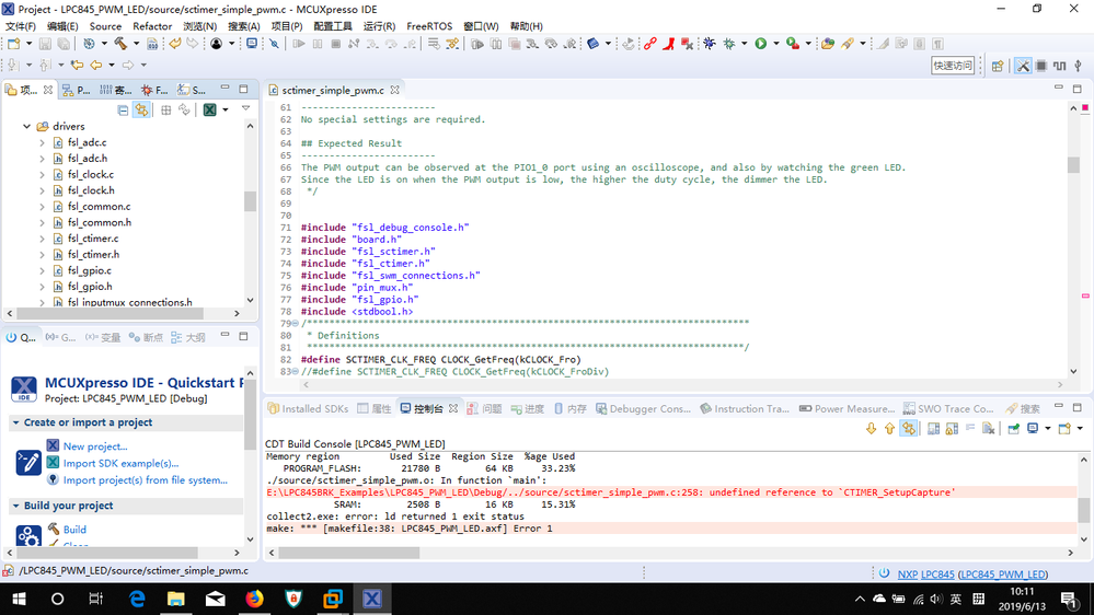

   What I used is Lpc845BRK, the code is from LPC845 SDK.
    I want to change PWM duty cycle every 4/8/16 PWM period, so I use CTIMER with capture mode to counter PWM rise edge, I have already included fsl_ctimer.h but an error occured, undefined reference to `CTIMER_SetupCapture'. I checked my project and I'm sure that fsl_ctimer.h and fsl_ctimer.c are in the drivers folder.
    What makes me confused is that I write CTIMER_Init() before CTIMER_SetupCapture(), the error is not on the line of Init, but on SetupCapture line.

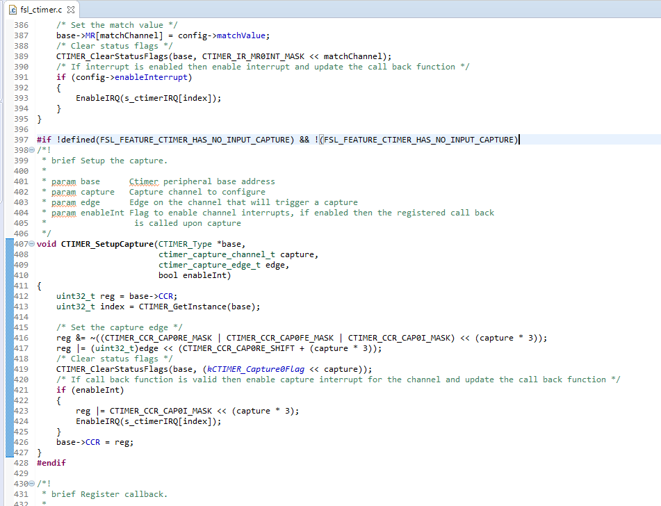

So I found what is going on. The reason why it is showing an undefined reference is because the function itself for the SetupCapture is commented out as it has a macro definition preventing its use.
I noticed that there is a typo in the definition as it does not make sense to be not defined and the value be one as it is right now. Try this:
#if !defined(FSL_FEATURE_CTIMER_HAS_NO_INPUT_CAPTURE) && !(FSL_FEATURE_CTIMER_HAS_NO_INPUT_CAPTURE)
or as it is right now remove the exclamation mark at the beginning but define the macro at the beginning of the document.
#if defined(FSL_FEATURE_CTIMER_HAS_NO_INPUT_CAPTURE) && FSL_FEATURE_CTIMER_HAS_NO_INPUT_CAPTURE
Try this and let me know if it works out for you.

Hi Sabina,
It works! Maybe SDC need update,
Thank you very much~

   Can you try to delete the files from the driver folder and add them again using the SDK management tool. You can do this by right clicking the project, then scroll down to SDK Management then click SDK Manage Components. Here you can select the ctimer driver again. Build your project and let me know the results.
Sabina
14,391 Views
mjx1995mjx
Hi Sabina,
     Thanks for your help.I followed your advise but not work.I delete the fsl_ctimer.h and fsl_ctimer.c from the driver folder, then I found  SDK management tool and selected ctimer, an error shown this.
   So I selected debug_console_lite, added files and built project.
   Unfortunately the error still exist.
