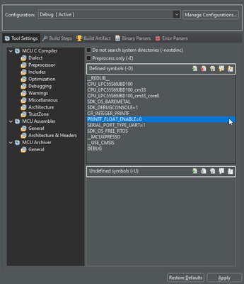

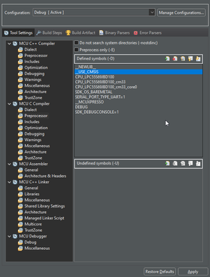

Hello @sushmasan,
I have successfully enabled float printing in your project. To achieve this, I made several configuration changes. Please review the following settings and apply them if needed:
In the LMC_target project:
Enable these options:
MCU C++ Compiler -> Preprocessor: Add the macro: __USE_CMSIS
MCU C Compiler -> Preprocessor: Add the macro: __USE_CMSIS
In the FreeRTOS_lib project:
Architecture & Headers: Set the option to: NewlibNano (auto)
Preprocessor: Remove the macro: PRINTF_FLOAT_ENABLE=0

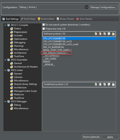

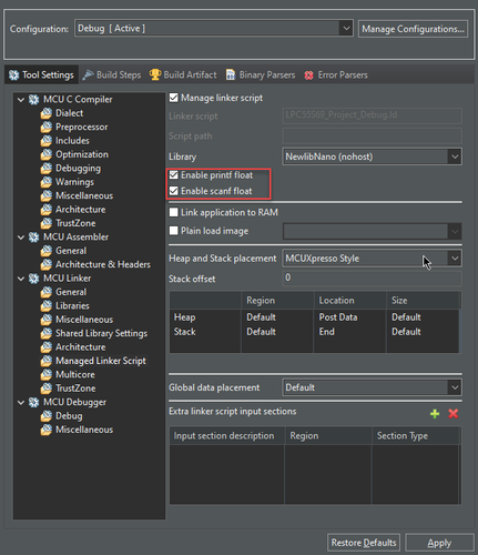

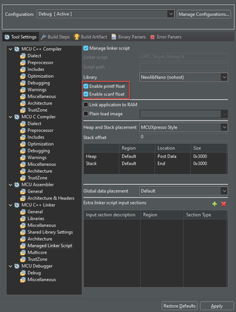

Please check if your project has the next configurations:
1. The macro called "SDK_DEBUGCONSOLE" enabled:
2. These options enabled:
3. The macro called "PRINTF_FLOAT_ENABLE" set to 1:
Habib

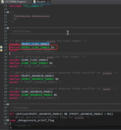

sushmasan
Hi @Habib_MS ,
SDK_DEBUGCONSOLE was already enabled, and "Enable Printf Float" also.
Where as "PRINTF_FLOAT_ENABLE" I just enabled in fsl_str.h, but there is no impact with this.
With all above 3 changes, there is no change in the behavior, which means I am not able to print double value.
But there is one compiler option under settings, when this is set to 1, the code under this flag is getting enabled (Inside this function -> int StrFormatPrintf(const char *fmt, va_list ap, char *buf, printfCb cb))
As I already mentioned in my initial message, when I set "PRINTF_FLOAT_ENABLE" to 1 under settings, none of the PRINTF messages are displayed.

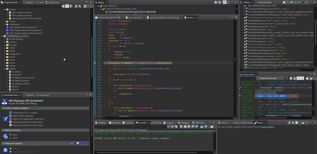

Habib_MS
Hello @sushmasan
I found that it is encountering a hardfault at the ASM instruction vldr d0, [r7, #48], as shown in the image below:
This instruction uses the FPU (Floating Point Unit) built into the core, which appears to be disabled. Please make sure that the FPU is correctly configured in your project, the function called "system_init" of CMSIS could be helpful with this issue. Please make sure that you declared the macro called __USE_CMSIS.

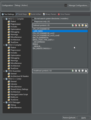

Hello @Habib_MS ,
This "__USE_CMSIS " macro was already enabled. If you see the settings I have shared in my previous message you can see that macro.
When you say this "Please make sure that the FPU is correctly configured in your project, the function called "system_init" of CMSIS could be helpful with this issue. " what do you think might be missing?

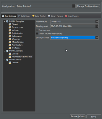

Habib_MS
Hello @sushmasan,
Habib
5,036 Views
sushmasan
Hello @Habib_MS ,
Thank you so much for your support.
I didn't realize that, the other dependent project pointing to RedLib library and I missed few build configurations too.
With these configuration changes, now I am able to print double value.
