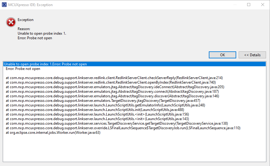

I've been trying to debug my LPC802 board for the past few days but it wont start the debug process using the MCUXpresso IDE. I get an "Unable to open prove index 1. Error: Probe not open" error message when i launch the debugging process. I have the SDK installed as well as a project loaded. I have tried erasing my flash, but that wouldn't connect as well. The following is the error I am prompted with.
If i proceed with OK. I get the following errors.
The jumpers are connected to JP7 and JP8 as default. I have not modified any of the boards content.

Hi Neesh Wi ,
for the opportunity to serve you.
Regard your question, I'd like to know more information.
1) Was the LPC802 board be able to debug before?
2) Can this LPC802 enter the ISP mode?
3) Whether you try to update the firmware of the on-board debugger.
3) Whether you try to use other IDEs to debug this board.

Hi Jeremy,
I was able to debug the LPC802 board previously using a different computer in school. I have also updated the firmare of the on-board debugger using the firmware file provided on the site.
I am unsure of how to get my LPC802 board into ISP more. I have tried using the nRST and ISP button built onto the board but that didnt solve the issue.

Hi Neesh Wi ,
Thank you for your reply.
The following post presents how to make the LPC8xx enter the ISP mode and build a connection with the Flash Magic, please refer to it for details.
https://learn.adafruit.com/getting-started-with-the-lpc810/programming-the-lpc810-with-flash-magic
