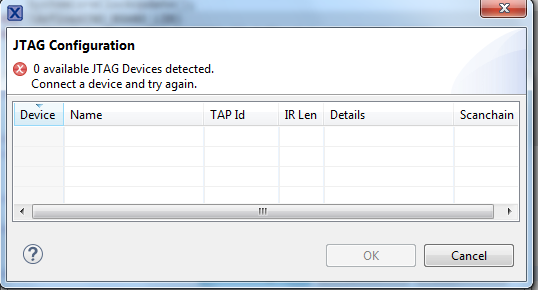

I am working on one of the project where i am using LPC4367JBD208 Controller. I am using MCUXpesso 10.3.1_2233 for my application development and  LPC Link 2 CMSIS DAP for debugging
I was debugging my application with M4 core and M0App core loaded. But suddenly the debug connection of M0App terminated. So i tried to relaunch M0App core only. But then both the Debug connection (M4 andM0App core) got terminated.
After that i tried to relaunch the debug session then it started showing below mentioned error.

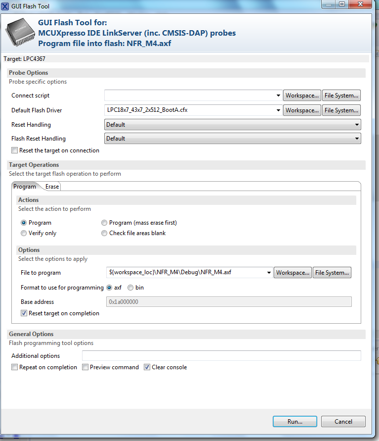

Then i loaded the code of M4 Core using GUI Flash tool
I was able to load the code in M4 Core and then i tried to relauch the debug conection but still the same error, 0Jtag Available. Then i tried to debug tthe M4 Core with SWD configuration there i was able to debug the core twice but then when i tried to load the code in M0App core using GUI glash tool it is not getting loaded.

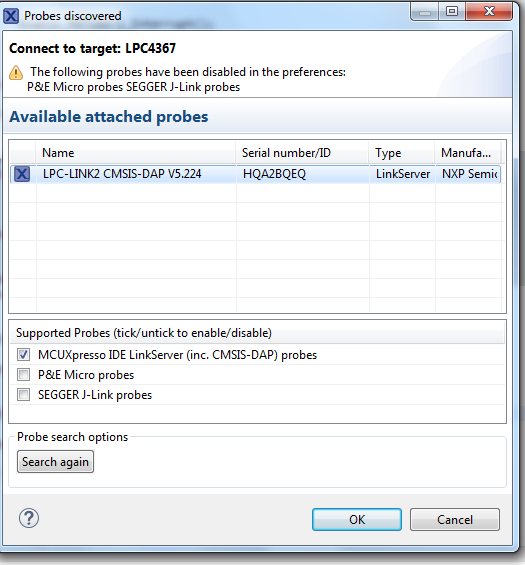

Then i tried Regaining debug access to target MCU  mthern which was working for me but now this also not working. As a result not able to do Mass erase. It is showing below mention error

Connecting to probe 1 core 0 (using server started externally) gave 'Ee(42). Could not connect to core.'
Server OK but no connection to probe 1 core 0 (after 3 attempts) - Ee(42). Could not connect to core.
Failed on connect: Ee(42). Could not connect to core.
No connection to chip's debug port
(100) Target Connection Failed
Unable to perform operation!

discussed  I also tried some solutions at the back ground by referring some forums discussion. Unable to connect to core    and Regaining debug access to target MCU   and tried to erase using GUI flash tools. following is the error log I got,

In regaining debug access, Boot into ISP will always recover your board, unless you have disabled ISP in your code. Other possibilities are the chip is broken (unlikely) or you are not supplying sufficient power, or your USB cable is faulty, or your computer USB port is fault.
