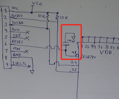

AshishKumar1109
I have attached the image of the custom board circuit. In this all the pin's that are not mentioned are used as inputs and outputs. Please suggest if there is any problem. Also while programming 3.3V is given externally to the controller.

ZhangJennie
HI
There is problem on your reset circuit design
please use RC circuit to produce reset . suggest R=100kΩ, C=0.1~1uF
Jun Zhang

AshishKumar1109
The 100nF capacitor was added after the FAE suggested.
Earlier we were not using this. Only there was a power on Reset circuitry that was in use.
30,563 Views
ZhangJennie
So in your reset circuit, R=1K, C=0.1uF?
30,557 Views
AshishKumar1109
Yes, this is used at power on basically.

ZhangJennie
The value of R*C is not enough.
Please try combination of R=100kΩ, C=0.1uF to make reset low longer.

AshishKumar1109
Tried with the combination no luck, still unable to program the controller with the issue.
