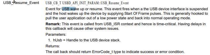

I've found that the USB_WAKEUP bit in STARTERP1 register accepts
not only USB_WAKEUP interrupt but also normal USB_IRQ,
and found my device recovered from Power-down mode(*) by normal DEV_INT
(DSUS_C=1/DSUS=0) without special handling about USB need_clcok signal
described in UM10462: "11.7.6.1 Waking up from Deep-sleep and Power-down modes on USB activity"
(*) it seems to be in Power-down mode because:
  (a) external 12MHz oscillator is stopped (confirmed by oscilloscope).
  (b) internal IRC might be stopped (confirmed thru CLKOUT pin).
  (c) power consumption 5.5mA is lower than that of 6.6mA while RESET-hold, or 8.9mA uart-ISP mode.
And also found that Systick interrupt has ability to wake up the chip from Power-down mode.
  (accurately, pending request of Systick prevent to sleep/WFI)
If these are true, please describe them somewhere in the UM10462, I hope...
4,702 Views
Alexis_A
Hello Shige,
In the following note, it mentions that the wake-up event is called from the USB_ISR:
But only to ensure the behavior of the module, I will suggest following the process mention in the 11.7.6 USB wake-up.
Alexis Andalon
