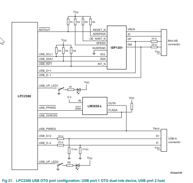

In which P3.24 is VBUS, P0.31 is D+2, Pin 37 is D-2, P1.30 is USB_PWRD2, P1.31 is USB_OVRCR2.

Alexis_A
Dear Mohammad,
The pin P3.24 can't be used as VBUS. This is the description of the pin P3.24
If you want to use VBUS you should connect it to the to P1.30
Or used it like the next schematic:

mohammadfaizan
Thanks Alexis,
Yes I had configured the P1.30 as a VBUS,
And I also try to run the existing code USBMem on Olimex board (LPC2478),
which has a USB device U1. But still I am facing the problem. Is their some
other things that I should need to change in the code.
Please help
