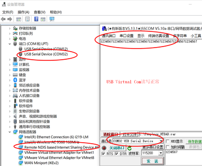

Hi there, i am attempting to run USB IAD, first device : rndis device, second device : usb vcom
i am able to make windows detect both device, usb rndis + usb vcom,
usb vcom is working , but usb rndis is not receiving or sending anything to me.
Can someone please check ?

Hi rijn
How does usb rndis work if you disable USB vcom?

rijn
no  it does not work.
rndis does not work even if i disable vcom

shaozhongliangs
@rijn
    The attached project is a simple demonstration program based on LPC54018/SDK/usb_examples/usb_device_composite_cdc_vcom_cdc_vcom.
It is enumerated as one RNDIS network port and one virtual COM.
This demo is to show how to build a composite USB device and to provide a
simple example for further development.
   I tested the demo on WIN10. It works fine.
IDE: KEIL
HW:LPC54018 EVK + FS USB port
