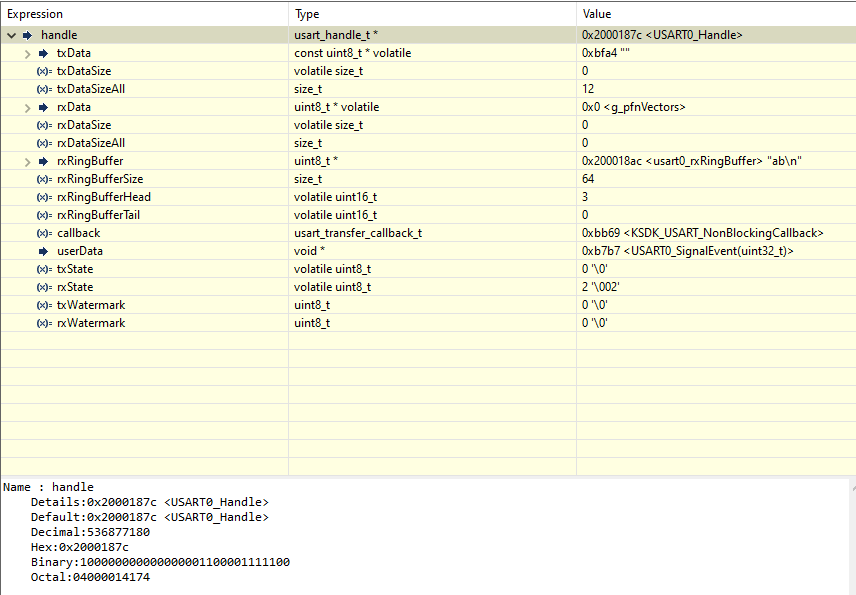

I can see in the debugger that the receive interrupt is called. The call stack is:
FLEXCOMM0_IRQHandler -> FLEXCOMM0_DriverIRQHandler -> USART_TransferHandleIRQ
in void USART_TransferHandleIRQ(USART_Type *base, usart_handle_t *handle) the handle struct looks like:
Received bytes have been stored in a RingBuffer handle->rxRingBuffer.
There are 3 bytes (handle->rxRingBufferHead ==3).
The user callback USART0_SignalEvent is stored in handle->userData and is called from KSDK_USART_NonBlockingCallback() (aka handle->callback) which in turn is called from USART_TransferHandleIRQ .
However, I do not see a call to handle->callback in the code for the "ringbuffer case". There's only a call to signal ringbuffer overflow:
handle->callback(base, handle, kStatus_USART_RxRingBufferOverrun, handle->userData);
Any idea what I might be missing here?

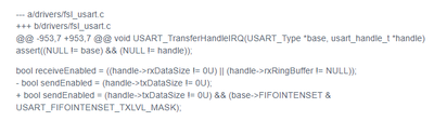

@frank_m I go through the other post and found the that, it is same issue which is i am facing.
I have made changes as per below image. I see some improvement but getting still same issue. I would appreciate your suggession.

I figured that the API is not designed as I expected it. From reading other documents on CMSIS I gleaned that I might have to initiate a read transfer first using e.g.
int32_t ARM_USART_Receive ( void * data, uint32_t num )
and then the ARM_USART_EVENT_RECEIVE_COMPLETE  event will be triggered as soon as the requested bytes have been read.
I wonder how to use this API if a limited but unknown numbers of characters are to be read, e.g., when using a line based text procotol? If I read one character after another that's inefficient, if I request more characters than which will be send, the event does not trigger.

            if (!sendEnabled)
                base->FIFOINTENCLR = USART_FIFOINTENCLR_TXLVL_MASK;
                base->INTENSET = USART_INTENSET_TXIDLEEN_MASK;
    /* Tx idle and the interrupt is enabled. */
    if ((0U != (base->INTENSET & USART_INTENSET_TXIDLEEN_MASK)) && (0U != (base->INTSTAT & USART_INTSTAT_TXIDLE_MASK)))
        /* Set txState to idle only when all data has been sent out to bus. */
        handle->txState = (uint8_t)kUSART_TxIdle;
        /* Disable tx idle interrupt */
        base->INTENCLR = USART_INTENCLR_TXIDLECLR_MASK;
        /* Trigger callback. */
        if (handle->callback != NULL)
            handle->callback(base, handle, kStatus_USART_TxIdle, handle->userData);
    /* ring buffer is not used */
    if (NULL == handle->rxRingBuffer)
        tmpsize = handle->rxDataSize;
        /* restore if rx transfer ends and rxLevel is different from default value */
        if ((tmpsize == 0U) && (USART_FIFOTRIG_RXLVL_GET(base) != handle->rxWatermark))
            base->FIFOTRIG =
                (base->FIFOTRIG & (~USART_FIFOTRIG_RXLVL_MASK)) | USART_FIFOTRIG_RXLVL(handle->rxWatermark);
        /* decrease level if rx transfer is bellow */
        if ((tmpsize != 0U) && (tmpsize < (USART_FIFOTRIG_RXLVL_GET(base) + 1U)))
            base->FIFOTRIG = (base->FIFOTRIG & (~USART_FIFOTRIG_RXLVL_MASK)) | (USART_FIFOTRIG_RXLVL(tmpsize - 1U));
Hope it can help you
XiangJun Rong
