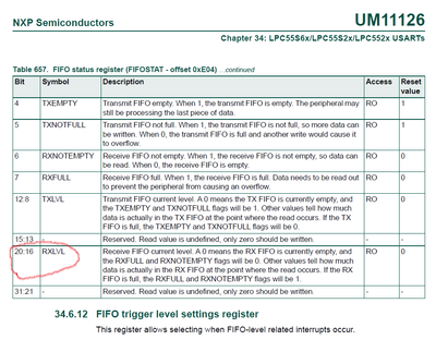

The FIFOSTAT[RXLVL] indicates how many bytes in the receiver FIFO, so you can read the value FIFOSTAT[RXLVL] and know now many bytes you can read in the ISR
Hope it is helpful.
XiangJun Rong

xiangjun_rong
As I said in the previous remarks, you can read the FIFOSTAT[RXLVL] bits to know how many chars in the receiver FIFO, then read all of them in the ISR.
Hope it can help you
XiangJun Rong
