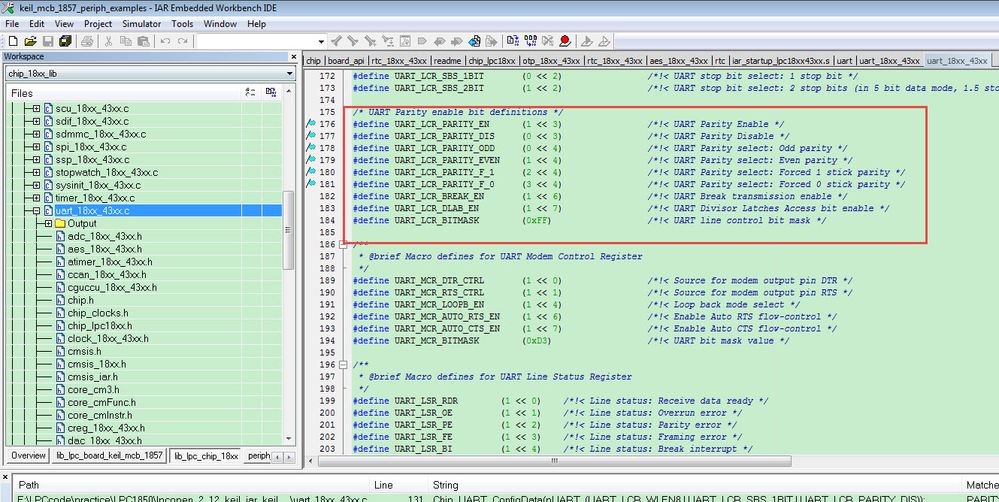

kerryzhou
Hi Vivien,
  Thank you for your more information, your lpcopen code is really the older version, it is v1.3, but now, we have v2.xx now, please refer to the newest lpcopen code:
LPCOpen Software for LPC18XX|NXP
  This problem has been fixed in the new version, just as I post it in the floor 2.
Wish it helps you!

vivienwong
  I agree that your snapshots are correct. I didn't think these were wrong in the first place. The user manual and the #defines are correct. It is the enum definition that is incorrect.
However in that same usart_001.h file, the enum,definition is what i think is incorrect. You can find this lower in the file after the #defines.

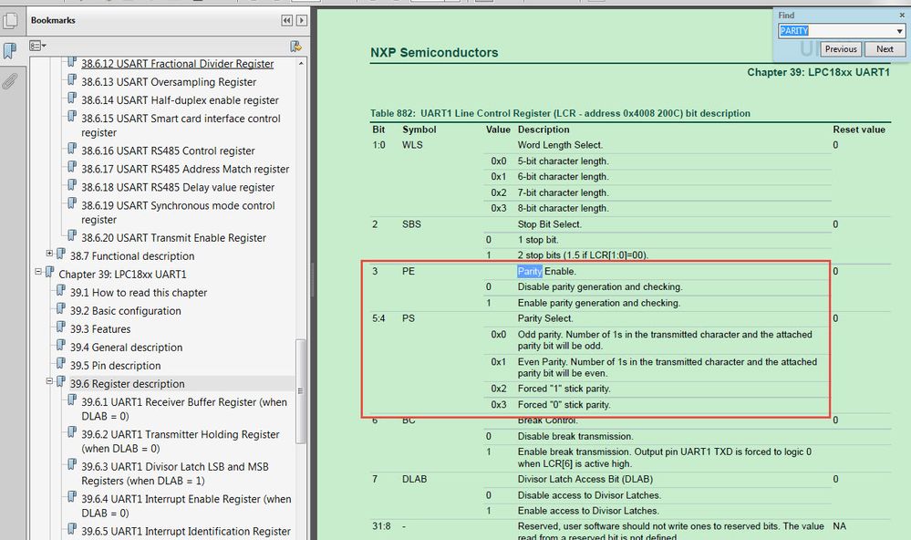

      Did you write the usart_001.h by yourself?  I can't find this header file. Did you get this file from the official website?
     odd parity, even parity, forced'1' and forece'0' stick parity are all bit 5:4 in the LCR register, enable disable parity is bit 3..
  Take your post code as an example:
You think incorrect item:
typedef enum IP_UART_PARITY {
    UART_PARITY_NONE = 0,                                    /*!< No parity */
    UART_PARITY_ODD = (4 << 3),                                /*!< Odd parity */
    UART_PARITY_EVEN = (5 << 3),                            /*!< Even parity */
    UART_PARITY_SP_1 = (6 << 3),                            /*!< Forced "1" stick parity */
    UART_PARITY_SP_0 = (7 << 3)                                /*!< Forced "0" stick parity */
} IP_UART_PARITY_T;
UART_PARITY_NONE =0;    bit3 is 0x0, disable parity should be 0
UART_PARITY_ODD = 0x20; bit5,4 is 0X2, but odd parity should be 0x0;  bit3 should be 1, not correct.
UART_PARITY_EVEN=0X28;  bit5,4 is 0X2, but even parity should be 0x1; not correct.
UART_PARITY_SP_1=0X30;  bit5,4 is 0X3, but SP_1 parity should be 0x2;  bit3 should be 1, not correct.
UART_PARITY_SP_0=0X38; bit5,4 is 0X3, but SP_0 parity should be 0x3; correct.

kerryzhou
Hi Vivien,
  Please tell us where you get  usart_001.h?
  I have check the lpcopen for LPC1857 from this link:
  The partity is defined like this:
And from the datasheet, we can get that:
  So, the lpcopen driver uart parity definition is correct, you can refer to our lpcopen driver.
Wish it helps you!
