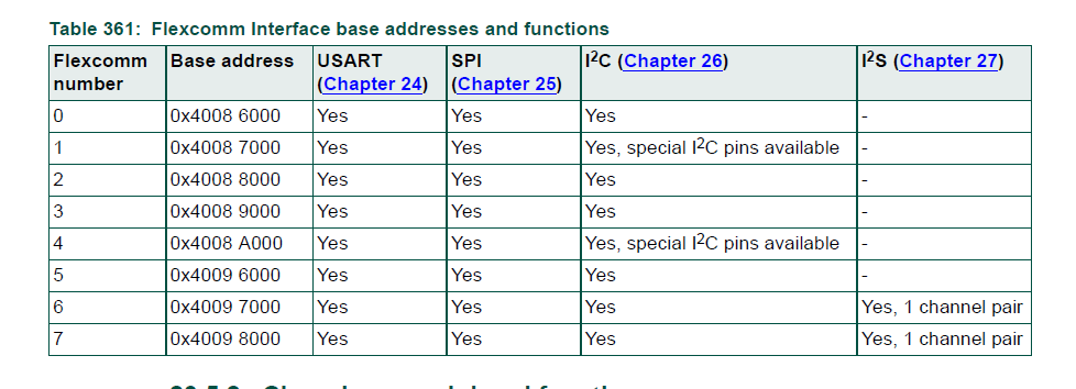

Hello , I'm currently working with the LPC51U68  that has 8FLEXCOMM interfaces that can support USART.
Does anyone knows if I can have two FLEXCOMM interfaces has USARTS running at the same time, one for debugging the other for communicaitong with a cpu, from a board that i am working on. In the previous version of this board the developer used a USART to communicate with the cpu but it did not have a USART for debugging.

Hi Carlos Medeiros,
      You can use multiple UART at the same time.
       Please check the user manual, this content:
So, actually, you can use 8 UARTs at the same time.
But , you said use one UART for debugging, what do you mean? Program the code to the chip or just used to printf some information? UART can't be used as the debugger.
So, maybe you can use it to printf some code run information, but you need to add the according code in your project.
Wish it helps you!
If you still have question about it,  please kindly let me know.
