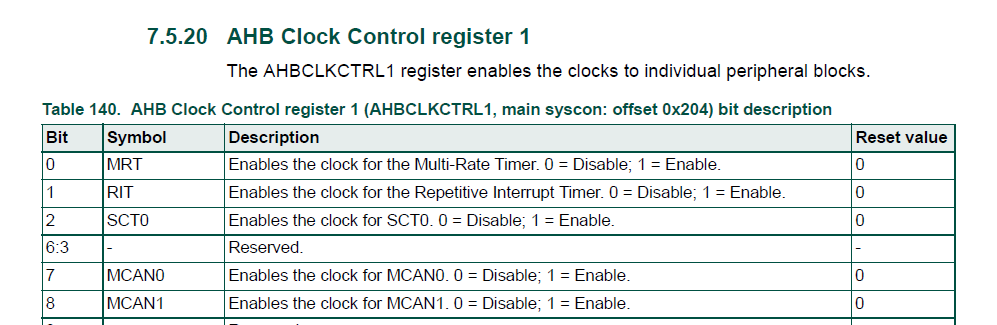

2,607 Views
xiangjun_rong
executing the following code MCAN_Init(), pls check if the CAN gated clock is enabled by checking the AHBCLKCTRL1.
XiangJun Rong
void MCAN_Init(CAN_Type *base, const mcan_config_t *config, uint32_t sourceClock_Hz)
#if !(defined(FSL_SDK_DISABLE_DRIVER_CLOCK_CONTROL) && FSL_SDK_DISABLE_DRIVER_CLOCK_CONTROL)
    /* Enable MCAN clock. */
    CLOCK_EnableClock(s_mcanClock[MCAN_GetInstance(base)]);
#endif /* FSL_SDK_DISABLE_DRIVER_CLOCK_CONTROL */
#if !(defined(FSL_FEATURE_MCAN_HAS_NO_RESET) && FSL_FEATURE_MCAN_HAS_NO_RESET)
    /* Reset the MCAN module */
    RESET_PeripheralReset(s_mcanResets[MCAN_GetInstance(base)]);
#endif
    MCAN_Reset(base);
    if (config->enableLoopBackInt)
        base->CCCR |= CAN_CCCR_TEST_MASK | CAN_CCCR_MON_MASK;
        base->TEST |= CAN_TEST_LBCK_MASK;
    if (config->enableLoopBackExt)
        base->CCCR |= CAN_CCCR_TEST_MASK;
    if (config->enableBusMon)
        base->CCCR |= CAN_CCCR_MON_MASK;
#if (defined(FSL_FEATURE_CAN_SUPPORT_CANFD) && FSL_FEATURE_CAN_SUPPORT_CANFD)
    if (config->enableCanfdNormal)
        base->CCCR |= CAN_CCCR_FDOE_MASK;
    if (config->enableCanfdSwitch)
        base->CCCR |= CAN_CCCR_FDOE_MASK | CAN_CCCR_BRSE_MASK;
#endif
    /* Set baud rate of arbitration and data phase. */
    MCAN_SetBaudRate(base, sourceClock_Hz, config->baudRateA, config->timingConfig);
    MCAN_SetBaudRateFD(base, sourceClock_Hz, config->baudRateD, config->timingConfig);
#endif
