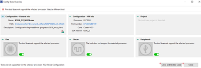

I recently migrated to the latest version of MCUXpresso (11.8) and the SDK(2.14).
I had been developing around the LPC55S16 (which is the core of the NXP development board).  However, we decided to us the LPC5516 (non-secure) instead.  I started to set up a new project for the LPC5516, but the clocks, pins and peripherals tools found in MCUXpresso report that they do not support the selected processor (See attached image).  Is this for real? Why is the secure version supported and not the non-secure version?  Is there any solution to overcome this?

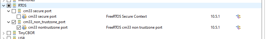

Though when I configured my recent project, I noticed that FreeRTOS comes in two different flavours for this device:
I assume that you are using the non_trustzone port for the LPC5516 part, aren't you?
7,273件の閲覧回数
JK_265
Yes, I am using the NTZ option

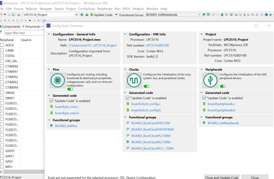

So it appears that part of my problem was that there were two projects in my workspace.  One for the LPC5514 and one for LPC5516.  It seems that the 14 does not work with any of the tools, and the 16 works with pins and clocks but not peripherals.  Is that accurate?
7,563件の閲覧回数

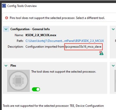

Hello @JK_265
From your screenshot, it seems your project is for lpc55s16:
How about creating a new project based on lpc5516, then check peripherals function.
I tested on my side, there is no problem:
Alice
7,544件の閲覧回数
JK_265
Hi @Alice_Yang.
Regarding your observation:
Yes, the project was initially opened based on my previously configuration for the S16.
However, at this point I have added the proper SDK and modified the MCU:
However, I have not saved the updated .MEX file, so perhaps this is a caching issue?
Even the online 'exploratory tools' for the micro does not offer the peripheral configuration option.
Pins Tool | MCUXpresso SDK Builder (nxp.com)
Thanks.
