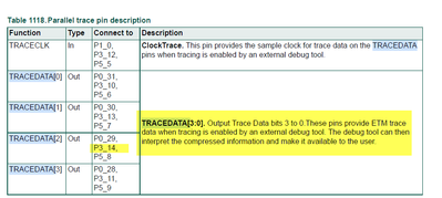

Because the J13 pin5 (P3_14) have the function of TRACEDATA, you can see from UM11060:
So I think the reason is, after you download the project one time, before next time, the code is running on your chip, this TRACEDATA pin (J13 pin5 ) is sending  10Hz square wave, not the correct Tace data debugger need, so failed.
You can test other SDK demo also connect the J13 pin1 and pin5, it can connect to the debugger can download well.

Are all four TRACEDATA signals exercised at the same time?  I attempted to use P3_10 @ J3[7] instead of P3_13 @ J3[5] and obtained the same result. P3_10 is also used for TRACEDATA[0]. Also, are these signals exercised all of the time that I am debugging?

I'm going to ask the same question in a different way.  I will be spinning a PCB with my current firmware.  If I want to be able to debug the new board, what do I need to do with the TRACEDATA signals?  Do they still get connected as they are on my LPC54018 development board?  If that is the case, then I cannot use the same processor pins for another purpose, such as a timer.
