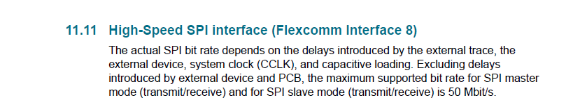

The data sheet of LPC55S69 says that the maximum supported bit rate for USART master and slave synchronous mode is 10 Mbit/s. The SPI is 50MBit/S.
