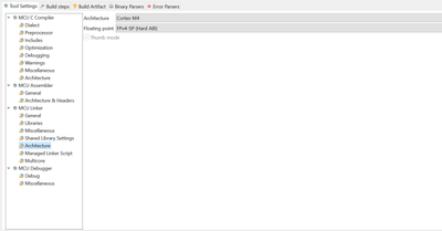

In addition, you can try going directly to MCUXpresso and change some settings on there, like this one:
Or trying to follow the suggestions on this thread from our community, too: https://community.nxp.com/t5/MCUXpresso-IDE/Unable-to-get-printf-to-print-floating-point/m-p/721059
Please let me know if the information was helpful, or if you still need help too. I will stay tuned to your answer.

prasannanaik
Hi @PabloAvalos ,
Thanks for your reply.
I have tried methods shared in both the links but none is useful.
My problem is that I am trying to build threadx library using command line feature of MCUXpresso.
When I use the built library in my project it results in the VFP register error as mentioned earlier.
As per threadx forum, there should be some way of enabling floating point access during compilation through command line.
I couldn't find the commands in the user manual.
Can you please go through the communication from threadx team below to understand the problem clearly:
https://github.com/azure-rtos/threadx/issues/184
