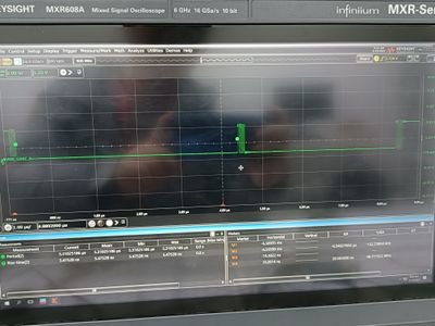

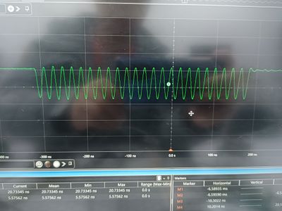

I use FC9 SPI as the master device. Send 24 clocks by writing three 8-bit data to the FIFO. The picture below is the clock waveform when sending.
But when I utilize both FC9 SPI and FC3 SPI in the same way, there is a long time gap between 3 8-bit data transmissions.
Below is part of my code

I have read your code, the control part of the FIFOWR register are 0x0x074E, 0x074E and 0x075E, the EOF(End of Frame) bit is NOT set, delay time is not inserted, I think the control code are correct.
From the spi clock signal waveform on the scope, it appears that the square-waveform   clock signal becomes a sine signal, I suppose the SPI clock signal(SCK) frequency is too high, which highlights the gap between two bytes.
Pls try to reduce the spi clock frequency.
Hope it can help you
