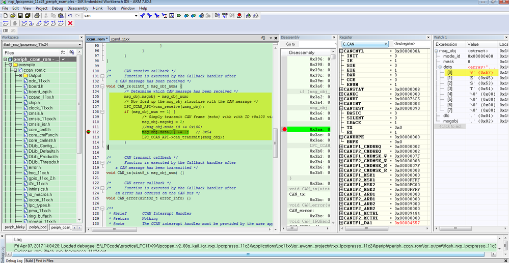

After you download the code to your ccan_rom.c, and debug it, you will find even you don't add the CAN node, you also can receive the data. this is my test result on lpcxpresso lpc11c24 board.
You can receive the correct data.
Please try my code on your side.

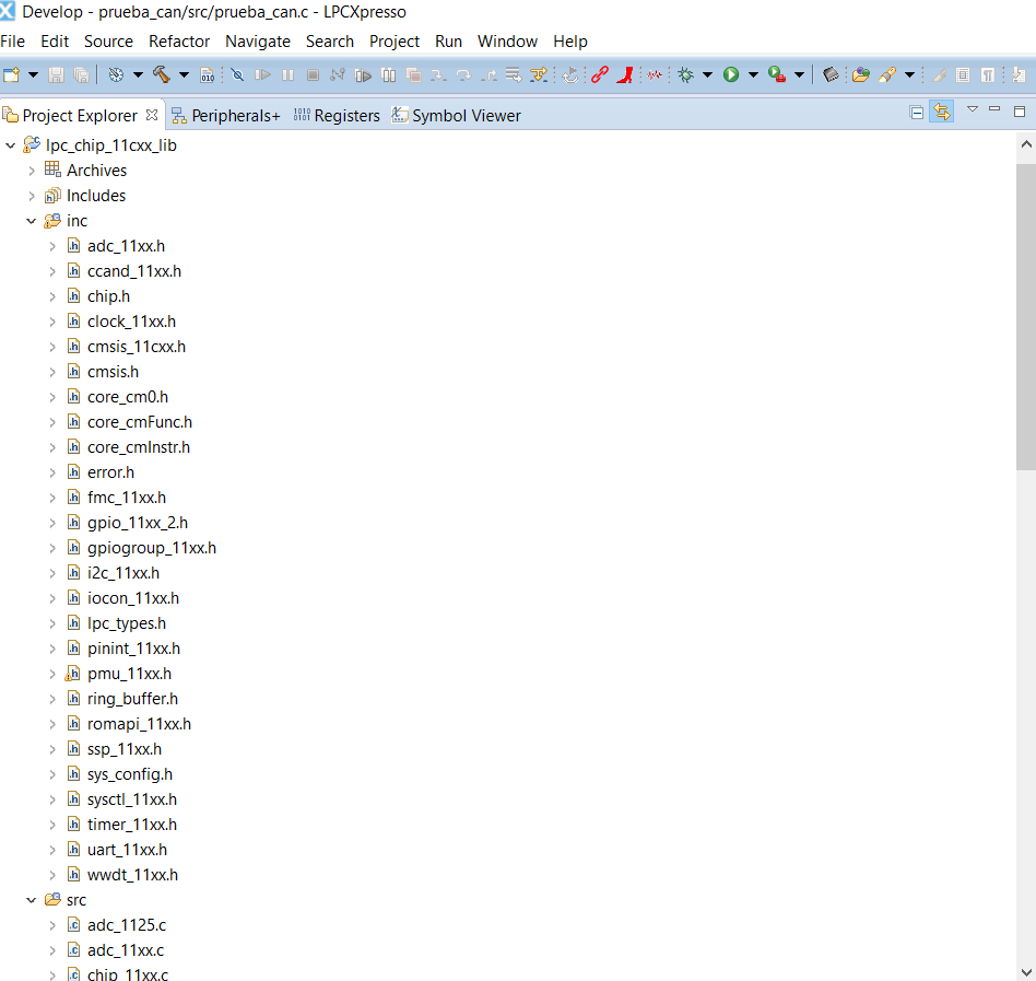

ainhoacortes
Hi Kerry,
Thank you very much for your response. I think it's very clear and this confirms my thoughts.
Only one easy question. I don't find the io_macros.h file anywhere. Could you send me the file? I do not know why I don't have it in my project, but in the structure I downloaded this file doesn't exist. In fact, I don't find anywhere in the web. In the following figure, you can see the files I have related to LPC chip:
Ainhoa
