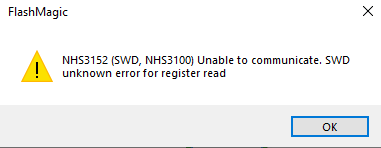

thank you very much for your answer. I checked all the things you mentioned and also again exchanged cabling etc. Still, flashing fails. FlashMagic shows this error message:
The LPC Link 2 board does appear in device manager.

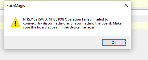

Sometimes also this error occurres when trying to use FlashMagic:
What could possibly be the problem?  Thanks again
4,611 Views
fangfang
It seems the lpc-link2 doesn't work. You may try MCU-Link Pro as the link.
