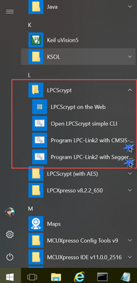

Is there any download error still? If you haven't downloaded code successfully, it's not possible
If fail download code, try update on board debug firmware with LPCScrypt.
try CMSIS-DAP first. If still fail, try Segger Jlink

I suggest you trying if IDE can connect board in ISP mode. press ISP button(SW2) on demo board when PC connects board with USB cable. To avoid old project/workspace association, test the project with a NEW project and NEW workspace.
If fail connect in ISP mode, update on board firmware with LPCScrypt, Here is LPCScrypt video and user guide.
