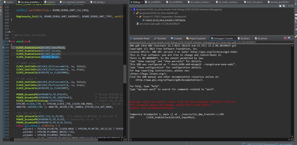

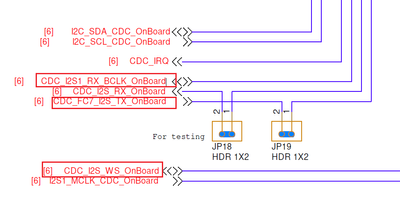

Hello.
I use LPC55s36 with unmodified i2s_dma_transfer example. From default pins i shorted JP3 1-2, JP53 1-2 and JP50 1-2, like the example says to do. Terminal says that it went throught all of the code and, theres no errors in terminal. Terminal:
Configure codec
Configure I2S
Setup looping playback of sine wave
But i can't hear anything in headphones. What could be the issue?

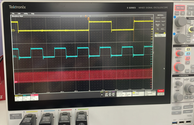

Hi @CzyzyK

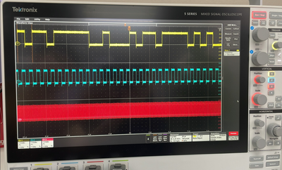

You can observe the output effect through an oscilloscope.

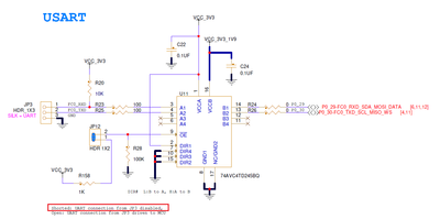

According to the schematic, you can measure these three signals.
HangZhang_0-1728629515364.pngHangZhang_0-1728629515364.pngHangZhang_1-1728629530179.pngHangZhang_1-1728629530179.pngHangZhang_2-1728629547183.pngHangZhang_2-1728629547183.png
The above is the result of my test, you can refer to it.
Hang

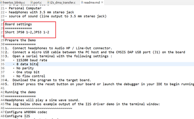

I checked the lpc55s36_i2s_dma_transfer demo readme.
Board settings
Short JP50 1-2,JP53 1-2
But in your setting,
"From default pins i shorted JP3 1-2, JP53 1-2 and JP50 1-2, like the example says to do. "
Why shorted JP3 1-2?
Hang
8,357 Views
CzyzyK
Hi @Harry_Zhang  , the description says to do so in import SKD examples. Removing shorting on JP3 1-2 didn't change anything.

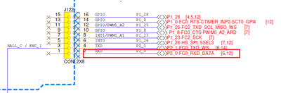

Harry_Zhang
Hi @CzyzyK
1. For CDC_I2S1_RX_BCLK_OnBoard signal, you can measure  the J9 Pin16.
2. For CDC_FC7_I2S_TX_OnBoard signal, you can measure  the J22 Pin2.
3. For CDC_I2S_WS_OnBoard signal, you can measure  the J22 Pin4.
Hang

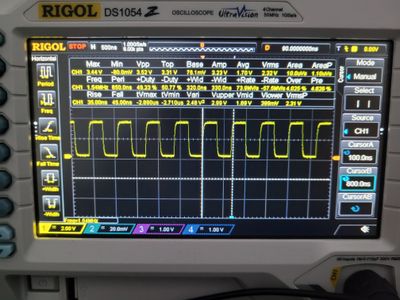

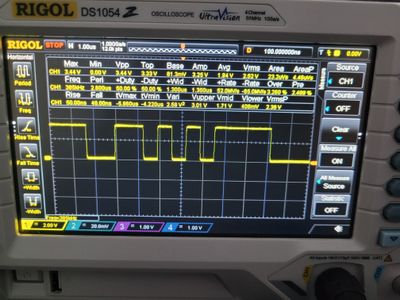

CzyzyK
Hi @Harry_Zhang , I2S and RX is fine i think, but TX is diffrent.
I2S:
RX:
 TX:
8,197 Views

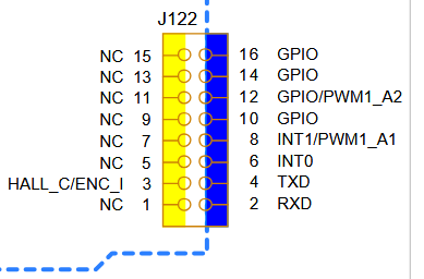

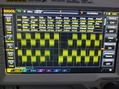

CzyzyK
Hi, @Harry_Zhang I checked this ones TXD on pin 4, with is near RX pin.
8,155 Views
Harry_Zhang
Hi @CzyzyK
The pin measured is correct.
Hang

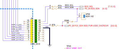

Harry_Zhang
Hi @CzyzyK

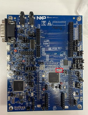

BH19 should be connected to BH20, but the board defaults to BH20 and BH21. You can try testing point BH20 to see the waveform.
Hang
