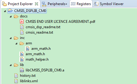

f_fiorini
That's odd, the file should be correct!
I made another .zip file with the same code, but I deleted the .project file from CMSIS library so it has to be manually imported now.
I hope this works.
In any case, I just discovered why it gets stuck in the DefaultIntHandler: my code is written in C++, so without putting "extern C" before the WAKEUP_IRQHandler the processor acts like the handler hasn't been defined.
After I did that, anyways, the code still gets stuck in the handler.
Apart from clearing the interrupt bits, what else should the interrupt do? Because I don't want my code to get stuck there indefinitely.

Inside the zip file there is an indication of where to locate the needed files and classes (in the README file in the main folder) plus the settings we are using (in "settings.xml"), I imported them in the MCUXpresso project before coding!
