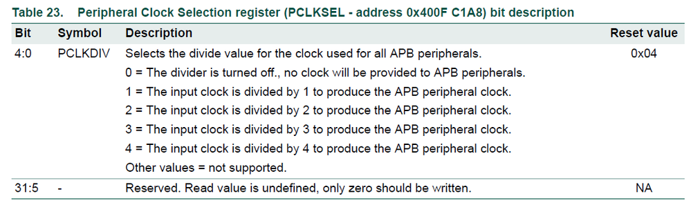

I'm developing an application which has to save some file to a SD Card.
At the moment I have some problem writing file into the SD Card.
I read some posts which suggested to drecrease the clock of the MCI peripheral.
I tried to decrease the clock and now I can write files into the SD Card.
The strange thingh is that in order to be able to write files into the SD Card I have to set the field PCLKDIV of PCLKSEL register to 8, but 8 is not a supported value.
As specified into the User Manual for LPC408x/407x, permitted value of PCLKDIV are 0, 1, 2, 4.
Can someone explain me how it it possible, and what I'm doing wrong?
And how can I decrease the clock of the MCI setting the field CLKDIV of CLOCK register?
Thanks a lot in advance.
Giovanni.
1,094 Views
soledad
Unfortunately, we cannot guaranty the behavior using another value. The values supported are 0, 1, 2, 3 and 4.
Did you test setting the value 1 or 4? Could you please try?
I suggest you use the lpcopen SD card demo code, please download lpcopenhttps://www.nxp.com/support/developer-resources/microcontrollers-developer-resources/lpcopen-libraries-and-examples/lpcopen-software-development-platform-lpc40xx:LPCOPEN-SOFTWARE-FOR-LPC40XX
in side package, there is demo app_sdmmc_meas, This example measures the performance of SD/MMC raw read & write operations.
