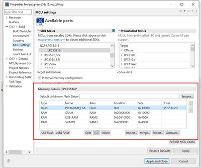

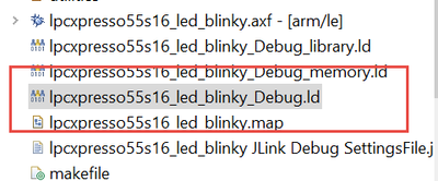

Hello @WorkerEmbedded
You can check memory detail as below:
Or linker files and .map file:
While, if you use SDK demo, the default memory is Flash.
Also please check the part number  in project is the same with your chip.
