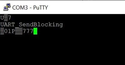

Hi all!
I'm trying to send some bytes through UART but I'm having some problems, probably because my old programming memories.
uint8_t array[]={0x80, 0x30, 0x31, 0x50};
for(i=0;i<4;i++){
Chip_UART_SendByte(LPC_USART, array[i]);
I'm sure it's an stupid question... but after check many examples I can't send my array byte by byte
Thanks in advance!

And this is the output:
Chip_UART_Send only sends the first character but not the first byte of my array

Hi @emimad
I hope you are doing well!
Could you let me know  which LPC board/MCU  and LPC drivers are you using?
Are you able to see any  part of your transmitted data array in the TX pin?  Or fails completely?
As a quick comment,  I would better call that function as below :

This is done in the LPC4347 LPCopen drivers.
And  make sure that the RX pins and the UART are properly clocked and configured as the UM mentions.

Thank you Diego!
I'm using a LPCXpresso LPC1347 board with MCUXpresso  IDE v11.4.0 and LPCOpen v2.05.
I tried your function:
