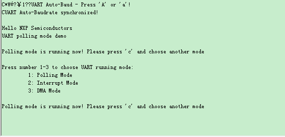

I am using LPC4330 chip and LPCXpresso IDE for programming.
My target is sending and receiving data from UART. I write below code for sending 1 Byte of data as primary test but I can not see any things on the oscilloscope.
Can someone tell me where is the problem? I use UART example for writing this code.
Please, if you know how to use UART for sending and receiving data from UART let me know.
The code:

Board_UART_Init(LPC_UART);
/* Enable UART Transmit */
Chip_UART_TXEnable(LPC_UART);
Chip_UART_Init(LPC_UART);
Chip_UART_SetBaud(LPC_UART, 115200);
Chip_UART_ConfigData(LPC_UART, UART_LCR_WLEN8 | UART_LCR_SBS_1BIT); /* Default 8-N-1 */
//Chip_UART_Init(pUART);
Chip_UART_SetBaud(LPC_UART,9600);
//Chip_GPIO_SetPinDIROutput(LPC_GPIO_PORT, 5, 1);
Chip_UART_Send(LPC_UART,buffer,10);

while(1) {
/* Reset FIFOs, Enable FIFOs and DMA mode in UART */
Chip_UART_SetupFIFOS(LPC_UART, (UART_FCR_FIFO_EN | UART_FCR_RX_RS |
UART_FCR_TX_RS | UART_FCR_DMAMODE_SEL | UART_FCR_TRG_LEV0));
/* Enable UART End of Auto baudrate & Auto baudrate timeout interrupts */
Chip_UART_IntEnable(LPC_UART, (UART_IER_ABEOINT | UART_IER_ABTOINT));
/* preemption = 1, sub-priority = 1 */
NVIC_SetPriority(UARTx_IRQn, 1);
/* Enable Interrupt for UART0 channel */
NVIC_EnableIRQ(UARTx_IRQn);
/* Send UART Autobaud completed message */
Chip_UART_SendBlocking(LPC_UART, uartABStart, sizeof(uartABStart));
/* ---------------------- Auto baud rate section ----------------------- */
/* Start auto baudrate mode */
Chip_UART_ABCmd(LPC_UART, UART_ACR_MODE0, true, ENABLE);
/* Loop until auto baudrate mode complete */
while (Chip_UART_GetABEOStatus(LPC_UART) == RESET) {}
Chip_UART_SendBlocking(LPC_UART, uartABComplete, sizeof(uartABComplete));

  This is the test result:
  You also can refer to the lpcopen code for LPCXpresso IDE, I have test it,it can printf out the data.
