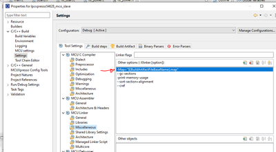

Dear frank_meyer, thank you for your answer. Where can I find the map file? there is a .map file (attached) in the project directory, but that one does not contain much information, especially not including those variables.

MCUXpresso enables map file creation by default.
Useful in many instances.
