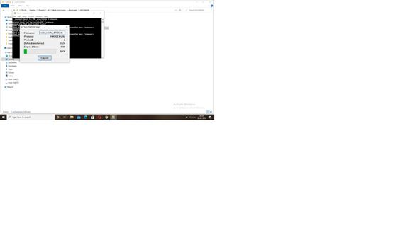

I have referred "https://www.nxp.com/docs/en/application-note-software/AN12384SW.zip" for creating the secondary bootloader project and application note referrred was "https://www.nxp.com/docs/en/application-note/AN12384.pdf".
The secondary bootlaoder code in the zip file was for KEIL IDE, i have ported the code to MCUXpresso IDE. I have attached the secondary bootloader code in this message. I have used Flexcomm 1 for UART communication instead of Flexcomm 0 used in the zip file secondary bootloader code.
During loading of Application code given in zip file, using Tera Term software using YMODEM, my Tera Term software gets stuck at 9.1% and ends there after timeout as shown in image below.
Tera Term software problem reference application code.jpgTera Term software problem reference application code.jpg

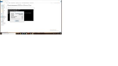

Also, while loading my Application code, the Tera Term software gets stuck at 0.3% as shown in image below
Tera Term problem custom application code.jpgTera Term problem custom application code.jpg
Please help in resolving this issue.

I have found the solution to the above problem.
I am using a different version of Tera Term software i.e. "TeraTerm-4.68", it is working now on the example application bin file.

Also, while sending my application code's bin file, the communication gives an error at 74.3% i.e when 262144 bytes of data has been transferred. What could be the problem?  Error code (-3) is returned by modem_recvdata() function.
