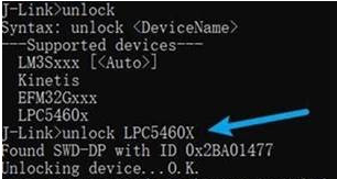

Hi markoLPC
Please try jlink commander unlock command. It may unclock SWD interface
Jennie
5,430 Views
markoLPC
Jennie thank you for suggestion.
We've tried, unfortunately unlocking was unsuccessful.
This is the JLink output:
J-Link>unlock LPC5460X
Unlocking device...failed.

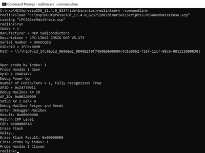

ZhangJennie
Not sure if your SWD is secured by ECRP.
Attached please find LPC546xxMassErase.scp.
Assume that you are also using MCUXpressoIDE_11.4.0_6237 and you have also installed it in C:\nxp\MCUXpressoIDE_11.4.0_6237.
  1. Please place LPC546xxMassErase.scp to C:\nxp\MCUXpressoIDE_11.4.0_6237\ide\binaries\Scripts.
  2. Open a Command Prompt window.
  3. Change the path to C:\nxp\MCUXpressoIDE_11.4.0_6237\ide\binaries.
  1. Execute the command of redlinkserv -commandline.
  2. After the execution of the command of redlinkserv -commandline, you should see redlink> prompt.
  1. Execute the command of load "C:\nxp\MCUXpressoIDE_11.4.0_6237\ide\binaries\Scripts\LPC546xxMassErase.scp".
  2. After the execution of the command of load "C:\nxp\MCUXpressoIDE_11.4.0_6237\ide\binaries\Scripts\LPC546xxMassErase.scp", you should see Loading " LPC546xxMassErase.scp".
  1. Execute the command of run.
  2. After the execution of the command of run, you should see messages below.
Jennie
