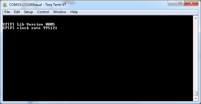

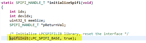

I have tried using the lpcspifilib example that comes with the latest LPCOpen package 2.20 for the NGX Explorer board, the problem occurs on the LPCSPIFILIB library initialization, the MCU hangs on that instruction forever:
This is the information I get on the terminal, the SPIFI clock seems to be correctly setup to run around 1MHz:

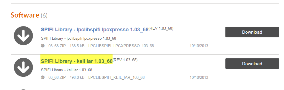

Seems the spifilib used in lpcopen_2_20_lpcxpresso_ngx_xplorer_4330 is V0.05.
It's too old.

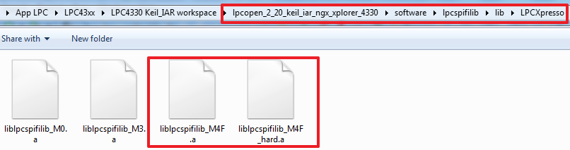

You can replace the lib file with the file in the lpcopen_2_20_keil_iar_ngx_xplorer_4330 package, which is supposed to be V1.01.
If it's still doesn't work, then use the latest V1.03 in the web site and try to debug with the source file instead of lib.

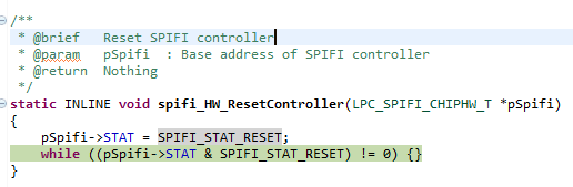

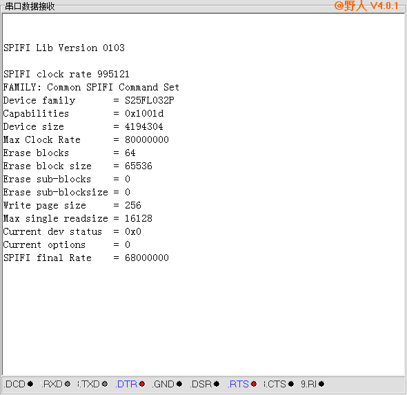

I have tried using the lpcspifilib example that comes with the latest LPCOpen package 2.20 for the NGX Explorer board and the standalone spifilib 1.03, the problem occurs on the LPCSPIFILIB library initialization, the MCU hangs on the SPIFI controller reset :
This is the information I get on the terminal:
Thanks in advance for your response.
Best regards!
Carlos Mendoza

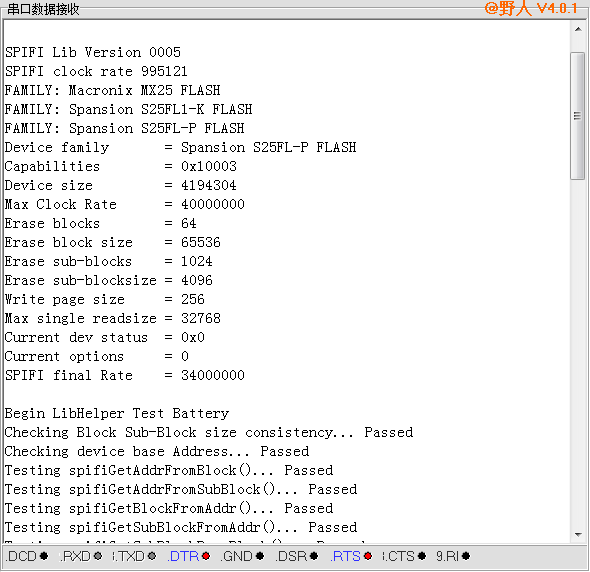

But I tried the LPCOpen 2.20 spifilib_tst project on the LPC4357 MCB board.
Both the V0.05 and V1.03 spifilib initialization works fine.
So i don't think this is the spifilib's issue.

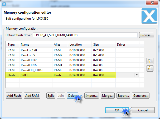

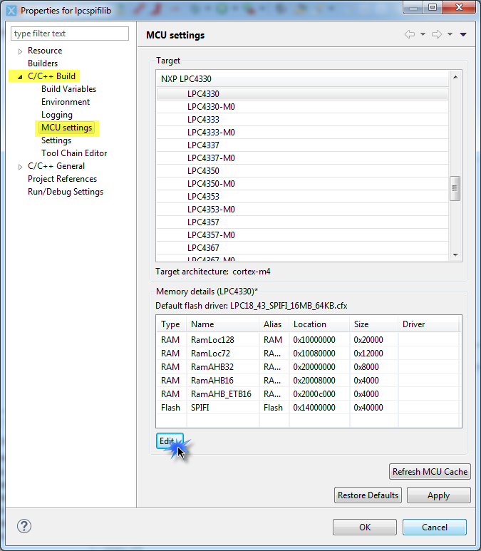

After reviewing the LPCSPIFILIB documentation I saw the following statement:
If you are using a SPIFI FLASH device as a execute-in-place memory for your LPC device, you can’t use the SPIFI library if it’s located in SPIFI FLASH. To use the library in this case, the library needs to be relocated to another memory (like IRAM) and the functions executed from there.
So as a quick test I edited the MCU settings in the project properties and removed the SPIFI Flash region so the code will run from RAM:
Clicked on Apply then OK:

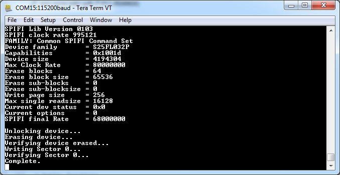

And rebuild the project, after this the project was able to run successfully:
Hope this helps!
