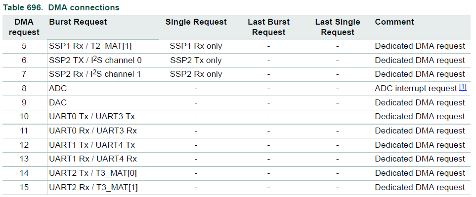

I am trying to understand how to use SPIFI in peripheral mode with DMA, but the information in the LPC407X/8X user manual (UM10562) seems incomplete: In the GPDMA chapter the SPIFI interface is not listed as supported interface. In the chapter on the NVIC, table 51 on page 81 also does not list the SPIFI interface as an interrupt source.
Am I missing something?

There's the reply from the AE team.
It indeed doesn't remark explicitly in UM...I believe it should support DMA in command mode based on the section "Peripheral mode DMA operation". I guess there could be an internal fixed request line input to DMA control or it could right be the unused burst request of DMA request 0 in Table 696. No matter which of the both possibilities, it means don't need do any programming for the users. Suggest to refer to the section "Peripheral mode DMA operation" without the request line selection for the usage of SPIFI DMA in command mode?

Hi Reinald Gerhardt,
It seems a bit weird, in Chapter 15: LPC408x/407x SPI flash interface (SPIFI), it says that the SPIFI mode support DMA feature, however, Table 696 doesn't contain the SPIFI DMA request. Definitely, it's inconsistent, I'd like to contact with AE for confirming and inform you later.
The SPIFI module doesn't support interrupt feature and hopes this is clear.
