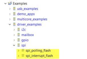

I haven't find the better demo under LPC54608 SDK package, while there is a one under LPC54114 SDK, you can
have a look:
"spi_interrupt_flash" is interrupt project, use "SPI_MasterTransferNonBlocking()", "spi_polling_flash" is polling read the external flash data, use "SPI_MasterTransferBlocking()" function. The same function can find in LPC54608.

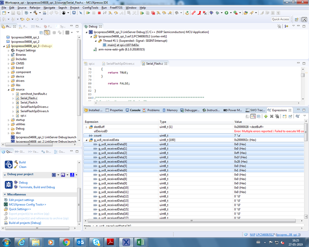

   Thanks for your input. I will try it and let you know. Meanwhile i had following observations while debugging my code:
1) I should get only 5 interrupt, 1 for "SPITransmit(1, (uint8_t*)&uc_ReadDeviceID_Opcode);" and 4 for "SPIReceive(4, (uint8_t*)&ulDeviceID);" but i am getting 7 interrupt.
2) The 7 interrupt result data is as follows:
So the bytes 1,0,28,1f are getting received but it is taking two more spi clock automatically even when i am not sending dummy bytes in those two bytes. Please help in understanding this.
