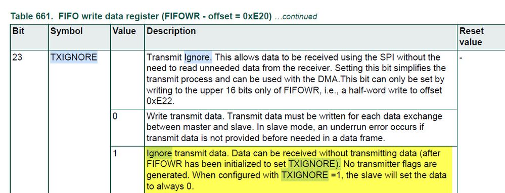

And if you just want to SPI slave receive, not send, you can try to the function of ignore transmit data :
(UM11126, P673)
Please also pay attention:
"To set-up a slave SPI for receive only, the control bit settings must be pushed into the
write FIFO to become active. Therefore, at least one write to the FIFOWR data bits must
be done to make the control bits active"
Regard,
Alice

rahulshah
Hi ,
I have added TXIGNORE=1 as follows (1<<23):
EXAMPLE_SPI_SLAVE->FIFOWR= (0x01|
((uint32_t)SPI_FIFOWR_LEN(kSPI_Data8Bits) |
(SPI_DEASSERT_ALL & (~SPI_DEASSERTNUM_SSEL(0)))) | (1 << 23)) ;
Also i have disabled tx-interrupt and disabled data sending from slave side from ISR  as follows :
// if ((SPI_GetStatusFlags(EXAMPLE_SPI_SLAVE) & kSPI_TxNotFullFlag) && (txIndex > 0U))
// SPI_WriteData(EXAMPLE_SPI_SLAVE, (uint16_t)(srcBuff[BUFFER_SIZE - txIndex]), 0);
// txIndex--;
After that i am not getting data properly from master:
Master sends : [0,1,2,3,4,5,6,7,8,9,10,11,12,13..........63]
Slave receives : [0,0,0,0,1,0,0,0,2,0,0,0,3,0,0,1....]
If i enable data sending from slave from ISR , then everything works fine.
I have added FIFOWR logic in init function so is that TXIGNORE bit set (1<<23) in FIFOWR is ok?
