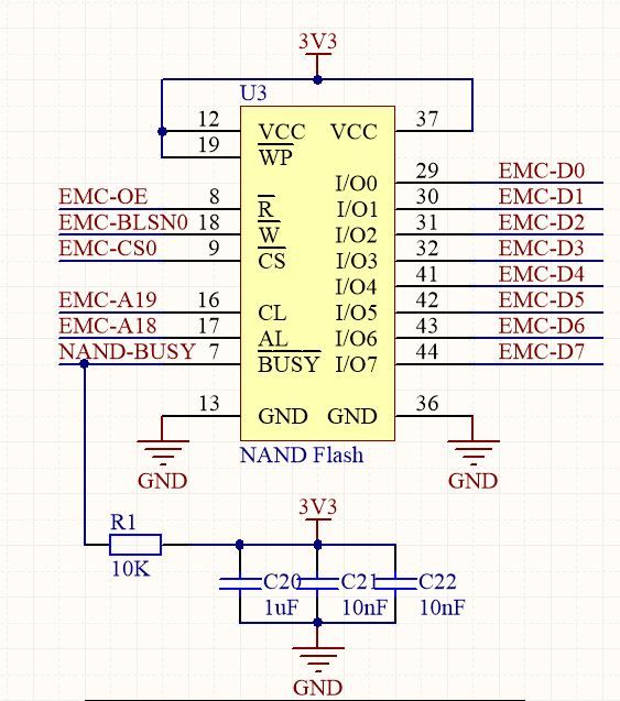

I have my first (test) board with the LPC54608 on my desk now. The board includes 8 MByte of SDRAM (x16 bit) and a NAND Flash (x8 bit) among other things.
The SDRAM works as it should, it passes various test patterns etc so I know that the interface for that one is working.
I also have a ST NAND256 Flash device mounted.
The EMC-WE (P0.15) signal is connected both to the SDRAM (WE#) and the NAND Flash (WE#).
The EMC-CSN0 (P0.16)  signal is connected to the NAND Flash as chip select.
(EMC-OE (P0.17), EMC-A18 (P3.29), EMC-A19 (P3.30) are connected to NAND Flash (R#, AL, CL))
The problem I see is that if I configure the Static memory controller 0 (CS0) and makes read access to address 0x80000000 and upwards, I see activity on the EMC-CSN0 and EMC-OE as expected. However, if I do write requests to the same area, I only see the EMC-CSN0 toggling and no activity on the EMC-WE pin.
(and remember, the SDRAM works fine, EMC-WE toggles nicely when accessing SDRAM)
Is there something specific I need to be aware of when dealing with static memory on the EMC bus of the LPC54608 especially with regards to the EMC-WE signal ?
The clock is set to 180 MHz
The init code for the static memory (I know, not pretty at the moment :smileywink:)
(Contents of the registers of the EMC static memory controller verified with Keil debugger)

found out what the problems was! The write signal for static memory is NOT the EMC_WE but rather the EMC_BLSN0..3 signals. When connecting the EMC_BLSN0 to the NAND Flash WE# pin it works.
I'm not sure it is exactly clear in the UM/DS what to use, Fig 116 on page 599 shows the "WE" signal going to the 8 bit memory device (and not BLSN0).
That coupled with the wording in Table 552 on page 574 confused me.
(also the fact that on the LPC177x the same schematics are shown in the UM on Fig 19. on page 206. Here WE is shown as write signal for a 8 bit memory device and on the LPC177x this is EMC_WE which works fine for an 8 bit device (no need to use EMC_BLSN0 for that device)

Thanks for your sharing, I was wondering if you can exemplify the sch of the conjunction of LPC54608 and NAND flash.
Ping
4,473 Views
carstengroen
Senior Contributor II
Hi Jeremy,
I have attached the part of the schematic with the NAND Flash, hope it makes sense.
Connections on LPC54608 is:
EMC-D0..EMC-D7: P0_02 - P0_09
EMC-OE: P0_17
EMC-BLSN0: P1_17
EMC-CS0: P0_16
EMC-A19: P3_30
EMC-A18: P3_29
NAND Busy is just connected to a GPIO
Static memory space 0 is set as 8 bit interface.
This places the NAND Flash at the following addresses:
#define DATA (*(volatile unsigned char*)0x80000000) // Bit 18 and 19 = Low
#define ADDR (*(volatile unsigned char*)0x80040000) // Bit 18 = High
#define CMD (*(volatile unsigned char*)0x80080000) // Bit 19 = High
