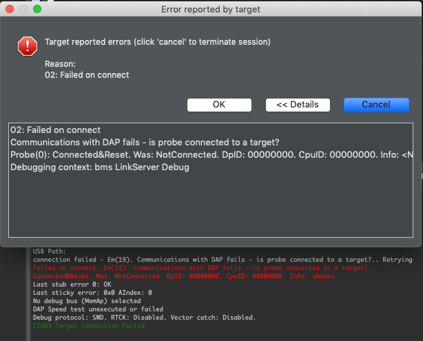

In addition, from when I ran the PMU test onwards I can't get the board working again, I also tried resetting it but apart from LED2 blinking, nothing happened.
This is the error I'm getting (see attached picture)Screenshot 2018-12-12 at 14.11.39.png

jeremyzhou
Hi Federico Fiorini,
I'd like to share an approach to fix this issue with you, please follow the below steps and you can learn how to use the Flash Magic via the link: https://learn.adafruit.com/getting-started-with-the-lpc810/programming-the-lpc810-with-flash-magic
1. Force the LPC11U35 enter the UART ISP mode.
2. Establish the connection between the MCU and Flash Magic.
3. Erase the full flash area in the MCU.
TIC

f_fiorini
Hi jeremyzhou‌,
Many thanks for the time spent answering! :smileyhappy:
Luckily I was able to reset the board (I don't know why previously resetting while asserting ISP didn't work...) and now I can go back to the code and find what's wrong with it.
