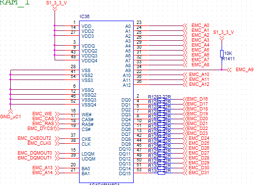

sven-ericweiss
hope you are still around.
I am trying to connect the AS4C16M16SA SDRAM (256Mbit, 16Mx16, 4 Banks, Row=12, Column=9) with my LPC4370, over the EMC interface.
My Configuration is nearly the same as the one you are using, so I am pretty sure the software is correct. Nevertheless it is not possible to write data in or out of the device. Thats why I assume that the hardware is incorrectly.
My problem is that I am not sure if it is possible to use the SDRAM in the way I connected it. Could you maybe take a look over my schematic and tell me if it is possible to connect the device this way?
