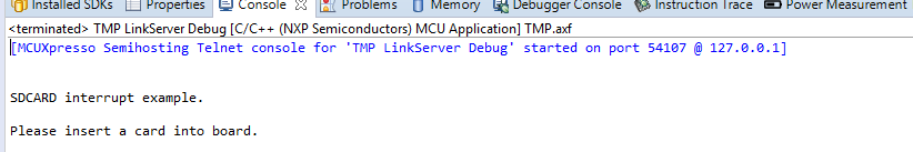

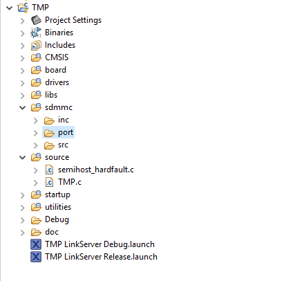

Lately I'm working on LPCXpresso 54628 with SDK_2.x. I have a project that contains using SDCard. When I imported sdcard_interrupt or sdcard_polling example it works. But if I try to import SD Card components (common and sd parts from middleware/memories) manually using SDK Components Manager, it seems there is one folder missing (called "port" from sdmmc folder) compared to example from SDK. When I try to copy this folder directly from example to my project there are no any errors, but it wont work either.
In the screen below you can see we are asked to insert the card into board but when I do this nothing happens.
Any ideas why?

I suggest to import the example including the component that you need copy and paste it in the project explorer and then modify this as required.
