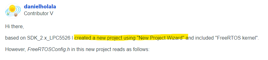

Hi there,
based on SDK_2.x_LPC5526 I created a new project using "New Project Wizard" and included "FreeRTOS kernel".
However, FreeRTOSConfig.h in this new project reads as follows:
#ifdef __NVIC_PRIO_BITS
/* __BVIC_PRIO_BITS will be specified when CMSIS is being used. */
#define configPRIO_BITS __NVIC_PRIO_BITS
#else
#define configPRIO_BITS 4 /* 15 priority levels */
#endif
That's wrong as Cortex-M33 core only uses 3 bits for interrupt priority.
The examples get it right. I assume that I should use an example's FreeRTOSConfig.h as starting point
So why does the New Project Wizard fail to include a correct FreeRTOSConfig.h ?

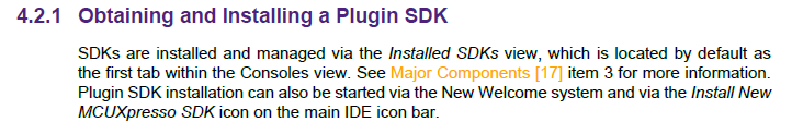

As a side note: The MCUXpresso IDE manual recommends to install and manage SDKs via the Installed SDKs view.
You suggest to deviate from the manual and to use the MCUXpresso SDK Builder on nxp.com instead. I wonder why this is. I think you should stick to the process that the manual suggests OR if the official recommendation now is to use the SDK Builder, change the manual accordingly.

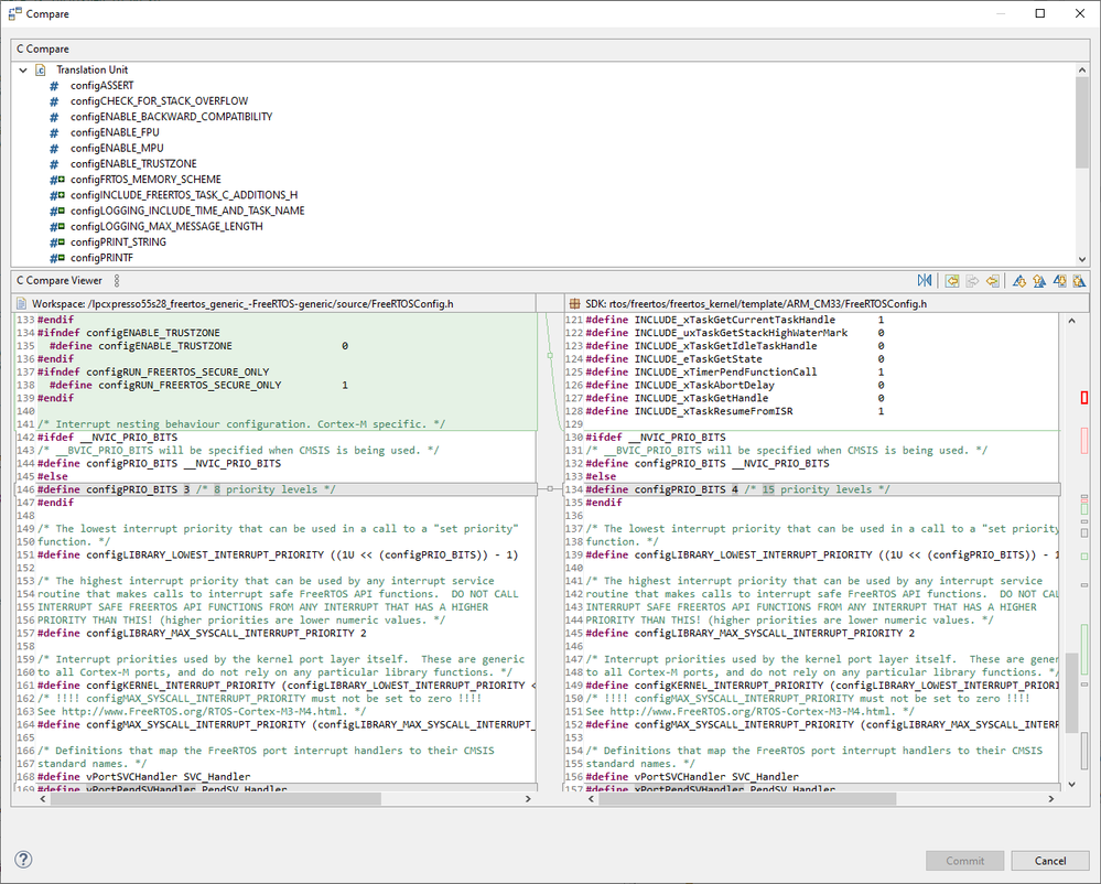

As I mentioned, the examples get it right.
However, as soon as I select "SDK Management" from the Project Explorer and then "Refresh SDK Components", the wizard offers to replace the example project's FreeRTOSConfig.h (configPRIO_BITS correct) with the template for FreeRTOSConfig.h from the SDK (configPRIO_BITS wrong).
The configuration files do not differ (or only in a few lines) from example to example. The diff to the template is very long. Obviously, the configuration files are not derived from the template configuration file.
That should be fixed.

Hi @CarlosGarabito ,
I wrote 'based on SDK_2.x_LPC5526 I created a new project using "New Project Wizard" and included "FreeRTOS kernel".'
I assume you are familiar with the use of MCUXpresso IDE, SDKs and project creation. Please see below and tell me, what more information do you need from me?

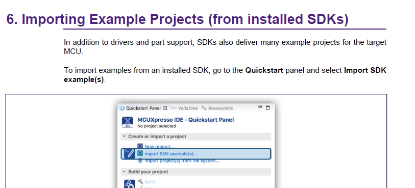

You wrote that you did: "create new project (File --> Project --> import SDK example "
That's importing an SDK example. And by the way, you are referring to the "File" menu but there's no "Project" submenu in there.
That being said, what I did was using "Quickstart Panel" and there "New project...".
Did you try this?
5,250 Views
CarlosGarabito
Yes, that's right, I forget to put new, so the steps are (create new project (File --> New --> Project -->import SDK example" which is the same as select in quickstart panel to select "import SDK example", my apologies for that.

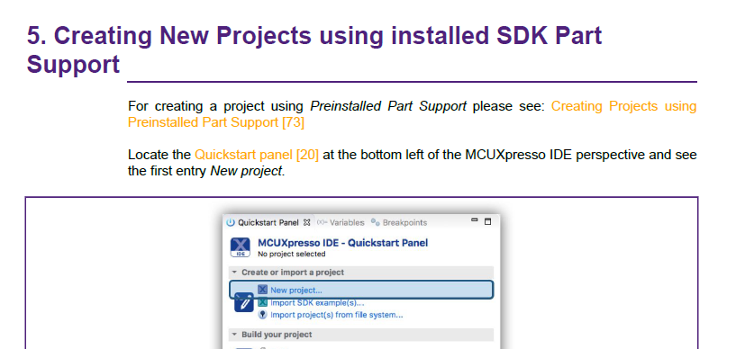

For the sake of correctnes: creating a new project and importing an SDK example are two different processes. When you say that you are creating a new project but at the same time recite steps import an SDK example your wording is ambiguous. That's not helpful.
Let's look at the User Manual as the reference for wording regarding MCUXpresso IDE:
Mind you, the issue I'm observing occurs only when you create a new project ("Quickstart Panel -> New Project..."). It does not occur when you import an SDK example.
