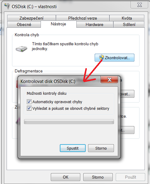

    1. You said, you are using only "Error Control" in Windows .
     Could you give me more details about this, give me a picture about it.

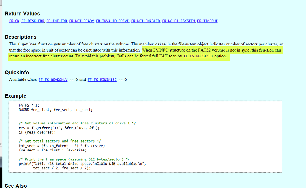

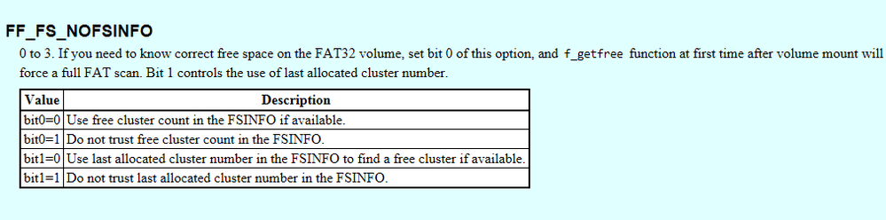

   3. About the software, f_getfree, after check the the fatfs official website,
FatFs - f_getfree
   I find these information:
FF_FS_NOFSINFO can be configured in the ffconf.h, you also can try this solutions.
Wish it helps you!
Kerry

Hello Kerry,
1) "Error control " - I thought (I have it only in Czech language):
2) I will try it, but the problem will habe the Customer again, when the card will not be formatted...

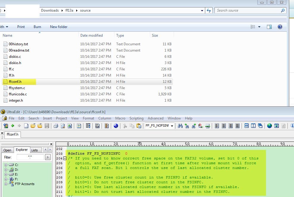

kerryzhou
Hi Jan,
   I think you can try the newest Fatfs file package, you can download it from the fatfs offiical website:
http://elm-chan.org/fsw/ff/arc/ff13a.zip
This package, ffconf.h have the FF_FS_NOFSINFO definition.
Kerry

phateee
So I did library update - ff13a.zip and then I set up  FF_FS_NOFSINFO  to 1 and it works:)
When I use old library, function f_getfree returns the same value. I can delete or add files, the return value was the same. Now it is correct...
