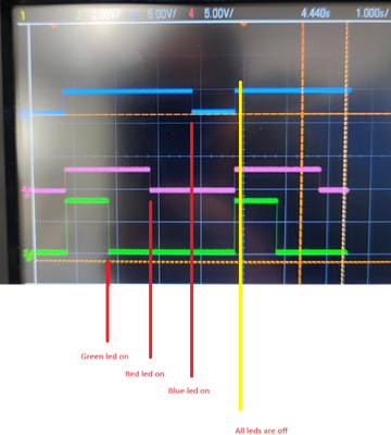

I'm using the LPC11U66 and I'm trying to turn on a different RGB led every second. In order to turn on the led, I need to set the pin low to sink the current. The timings are correct.
The problem that I'm having is I can set the pins low, but I can't set them high to turn a specific led off, until the whole sequence is done. The led sequence should be:
Green led, Red led, Blue led, but actually I'm get mixture of colours as the led that should be off, aren't.
I was wondering if there is a setting that I'm missing ?

1,159 Views
Mr_Damian
Managed to resolve this issue, by just updating the outputs that needed changing of state and ignoring the ones that need to remain the same.
Solution :
LPC_SCT0->OUT[1].CLR = (1 << 0); //Clear Output 1 Green when event 1 occurs
LPC_SCT0->OUT[1].SET = (1 << 1);
LPC_SCT0->OUT[2].CLR = (1 << 1); //Clear Output 2 Red when event 1 occurs
LPC_SCT0->OUT[2].SET = (1 << 2);
LPC_SCT0->OUT[3].CLR = (1 << 2); //Clear Output 3 Blue when event 0 occurs
LPC_SCT0->OUT[3].SET = (1 << 3);
