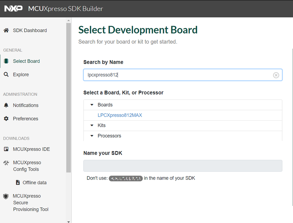

If you would like further reference examples. You can download the SDK for the LPCXpresso812MAX which is one of our evaluation boards that use the same microcontroller you are working with.
Once downloaded, you can open the demo examples in the MCUxpresso IDE.
Here are the one included for SCTimer:
If you have further questions, let me know!
