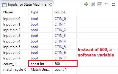

Hello Community,
first of all, sorry for my bad english.
I use the LPC1549 Board and i want to create a Red State Machine file with the SCT0.
My program should be toogle the SCT0_OUT3, but it don´t work =(

As attachment to find an image of my created state machine.
I hope someone can help me. Thanks alot!

larsemkes
Thank you for the answer. i solved my problem with the cookbook from NXP.
But now i have an other problem =(:
Is it possible to connect a (Software) variable to the source of an input for State Machine?
I want to increment a variable in my main program.
As attachment to find an image of my problem.
Thanks alot!
