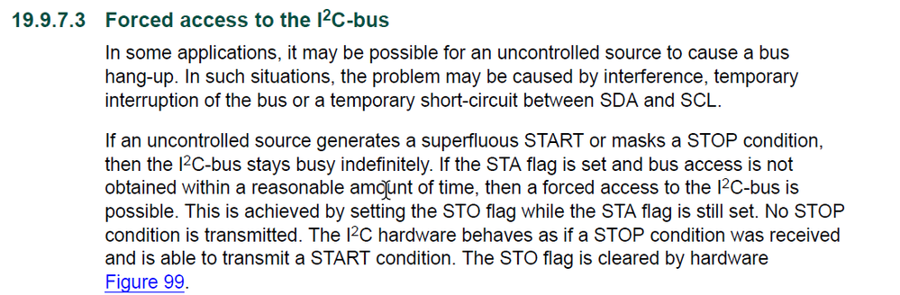

Hello Daniel Kabs,
Thanks for your sharing.
I think your suggestion is good. About timeout, we can see in the User Manual for LPC chip( for example LPC176x):
In some applications, it may be possible for an uncontrolled source to cause a bus
hang-up.
If the STA flag is set and bus access is not obtained within a reasonable amount of time, then a forced access to the I2C-bus is possible. This is achieved by setting the STO flag, just like your code on interrupt function Chip_I2C_EventHandler().
Alice
