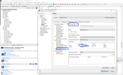

I suppose that the GUI_ALLOC_AssignMemory((void*)MemoryBuff, GUI_NUMBYTES) api function allocates memory from heap.
As the following screenshot, you can allocate the heap from SDRAM. Furthermore, you have to initialize the SDRAM in the main() with the line BOARD_InitSDRAM();
Pls have a try.
Hope it can help you
XiangJun Rong

SunnyT
Dear @xiangjun_rong
Thanks for your fast reply.
I tried out the solution what you have mentioned as per image but still it is  hung  there  in  GUI_ALLOC_AssignMemory((void*)MemoryBuff, GUI_NUMBYTES) api function only. Can you suggest any other possible solution .

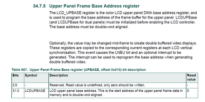

xiangjun_rong
I do not know where  the api function GUI_ALLOC_AssignMemory(); is? is it included in SDK package for LPC?
Anyway, as a workaround, I suppose you can declare a data pointer, for example
uint64_t *MemoryBuff;
MemoryBuff=(uint64_t)0xA0000_0000; //dependent the SDRAM chip select pin
Note that the low three bits 2:0 must be zero, so the pointer must be uint64_t type.
