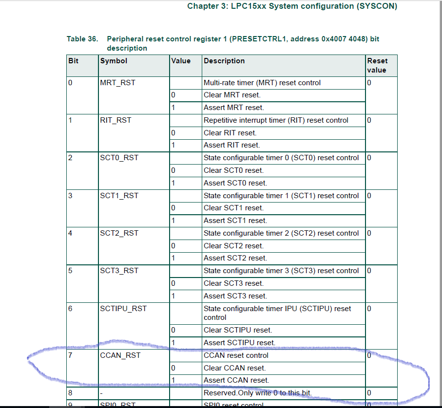

What's the best way to get the CANbus going again after it has stopped?
Example - customer disconnects the CAN cable - CANbus interface detects the fault and stops. What is the best way to restart it without having to restart the program from hardware reset?
Labels (2)
1,570 Views
xiangjun_rong
Hi, Ian,
I suppose that you use LPC175x, if it is the case, you can reset only the CAN module with the bit CCAN_RST bit, in other words, you can set the bit, then clear the bit, the CAN module  will be reset, then you can reinitialize the CAN module.
