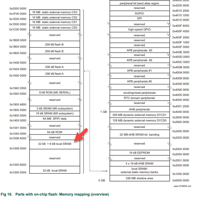

Alexis_A
Dear S S,
     1-.   Yes, you could try returning other status, only remember that the code will get stuck in the assert in the assert             instrucction. Maybe after the timeout you could try a software reset or module reinitialization.
      2.- It's important when a high speed stack is being used like USB or Ethernet that the storage is in a rapid access             memory. That's why this buffers are being stored in the second section of SRAM
Let me know if this helps you.
