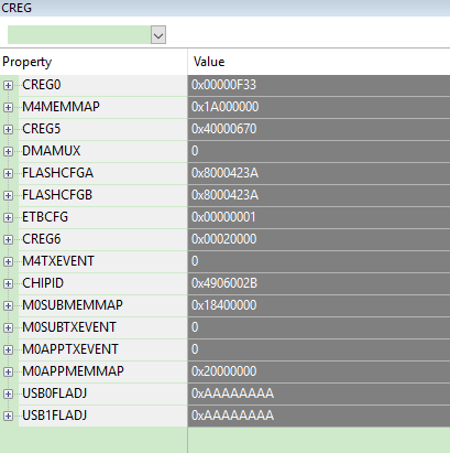

I'm using LPC4357 with Keil, and when I view the contents of CREG (in either the memory viewer or the system viewer) the MCU locks up and I get the error "Could not halt Cortex-M device". It seems to be most sensitive to views in the USB0FLADJ  and USB1FLADJ regions, because I can view lower regions of CREG with the IDE only complaining about not being able to access some these memory locations. I can't tell if it's going off into the weeds, or actually locks up, but the LED's stop flashing for a Blinky example, and requires a power cycle to be able to connect to the LPC again.

What's the means of "why Keil is unable to read CREG addresses below the FLADJ registers?"
I could read the CREG registers info from system view window:
Mike

The information in the LPC43xx User's Manual implies, that this issue is based on the chip specific implementation:
Remark: The FLADJ register must be read only after initializing the USB interface.
Reading this register before initialization of the USB causes the MCU to stall.
So I would say that it is not an issue with KEIL µVision.
